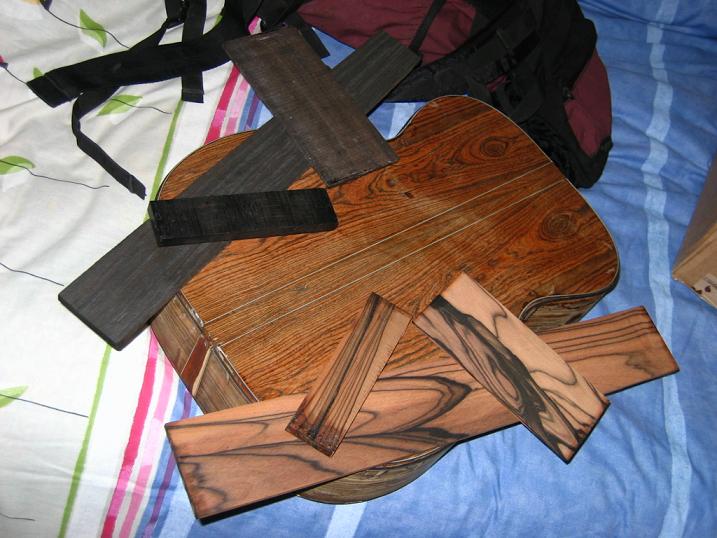

I Have.
and as Bob said, while it is a cordia, i had none of the cracking problems i had with ziricote.
it reminded me of a a green/black EIR really...
both in price & workability.
aint got too many pics but heres one and heres a link to a thread i started showing this guitar while in construction...
my bocote build
Udi.
